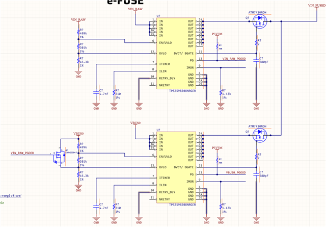

I am designing a priority mux using TPS25983. I want to use UVLO and OVLO, therefore I am controlling the secondary eFuse with the PGOOD signal from the primary. Is this approach correct? Do you see any drawbacks? Can you please review my approach?

  • Hi caner,
    I don't see any concern in the method. For the implementation, I would recommend pulling EN low using the FET instead of shorting the OVLO pin to Supply. Shorting the OVLO pin to Vin may result in abs max violation of the device (depending on the operating voltage condition).
