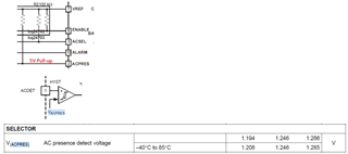

1) Even if ACPRES is pull-up to VREF(5V), is the VACPRES value 1.208~1.285V?
2) If number 1 is correct, if 2-4V voltage is applied only to ACDET pins, IC is not in power saving mode and is operating normally, right?
Thank you.

  • Hello Jaeho,
    This is a legacy device, so we have limited information on this device except for what is in the datasheet. I also do not have a BQ24703 EVM, so I am unable to test this question.
    This information is based on what is in the datasheet:
    Yes, This is correct.
    No, The input supply has to be between 4.5V-28V. I recommend ordering an EVM to get a better understanding of the device.
