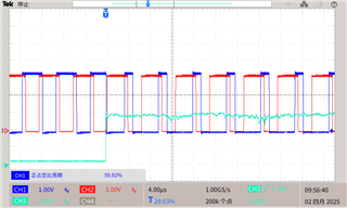

ch1:DPWM0A ch2:DPWM0B ch3:AD03
The opology is BUCK. So the dutu maybe above 50%.The DPWM mode is Multi Mode. The requirement is CBC on DPWM0A only and DPW0B duty cycle matches to DPWM0A. The DPWM Setting is as follow:
In the datasheet(Page49 table2-5), the mentioned registers have been set. But in the test wave, DPW0B is not match DPWM0A.
FaultMuxRegs.ACOMPCTRL0.bit.ACOMP_B_THRESH = 100;
FaultMuxRegs.ACOMPCTRL0.bit.ACOMP_B_SEL = 0; /* Use threshold register for trip */
FaultMuxRegs.ACOMPCTRL0.bit.ACOMP_B_POL = 1; /* Above thresh to trip */
FaultMuxRegs.DPWM0CLIM.bit.ACOMP_B_EN = 1;
FaultMuxRegs.DPWM1CLIM.bit.ACOMP_B_EN = 1;
Can you help me to see that which register not set? Thank you very much!

    Can you show your DPWM0 initialization? It looks like even before the ACOMP_B is tripped, there is already overlap between the DPWM0A and DPWM0B phases. Is there still overlap even if the CBC is disabled? There should not be any time when the DPWM0A and DPWM0B are on at the same time or else you risk overshoot.
    Also, if the DPWM0B duty cycle matches the DPWM0A duty cycle, then if the CBC cuts DPWM0A from ex. 40% to 20%, then the DPWM0B duty cycle will stay at 40% since the CBC for phase B was not enabled. Is this the desired behavior you are looking for?

    The DPWM0A and DPWM0B max duty maybe 96%,so there is overlap between the DPWM0A and DPWM0B phases. The dpwm mode is multi mode. If the CBC cuts DPWM0A from ex.80% to 50%,the DPWM0B duty cycle will match 50%. Is that possible?

    If the DPWM0A is cut from 80% to 50% by the CBC and you also want to cut the DPWM0B to 50%, then I think the easiest method would be to also activate the CBC for DPWM0B. If you do not want to do that, then can you use DPWM0A and DPWM1A and have DPWM0A be the master to DPWM1A? It can be DPWM1A, DPWM2A or DPWM3A.
        ---- Yes. I do it. But the DPWM0B do not active the CBC after the fault occur. you can the wave above.

    I thought your original waveforms show the CBC enabled on DPWM0A only. Is the CBC for DPWM0B enabled in your original waveform too?
