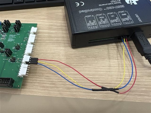

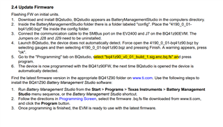

I am checking the bq41z90 EV Board.
As shown in the User guide, we ran bqstudio using 4190_02-bq41z90.bqz and programmed bq41z90_v0_02_build_5.sig.enc.bq.
However, as soon as I press the program button, the programming tap disappears, and the SMB is not connected. I would appreciate it if you could tell me how to solve it.

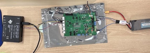

Attached is a picture of the EV board connection.
Thank you
HJ

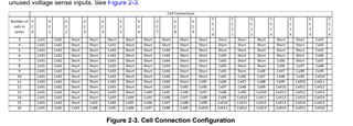

  • Hello HJ_KIM,
    The biggest reasoning behind the EVM not working is due to not shorting the leftover voltages taps, from the picture I can't tell how many cells in series is the pack but please follow the image below in the EVM.
    EVM:
    https://www.ti.com/lit/ug/sluud64/sluud64.pdf?ts=1743606829119&ref_url=https%253A%252F%252Fwww.ti.com%252Fproduct%252FBQ41Z90

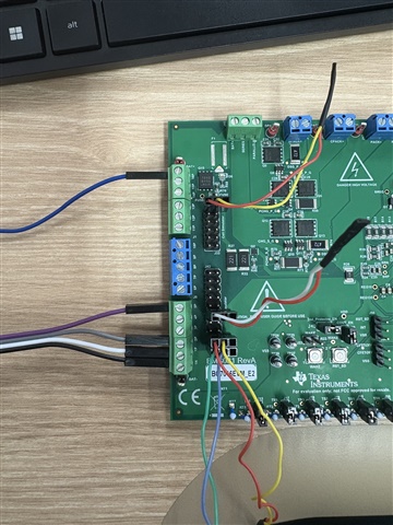

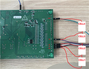

  • Hello.
    As you said, I did short between cells, but it doesn't get the same progarm. Even the D6 LED won't turn on when I connect it like this.
    Please check if the connection in the attached picture is correct.
    And the problem is that SMB communication and PROGRAM won't work. Is there a way to do communication and PROGRAM using external power without connecting the battery?
    Anyway, the current problem is that the programming tap disappears when the BQSTUDIO forced execution -> PROGRAM button is pressed. Please guide me on how to solve it.

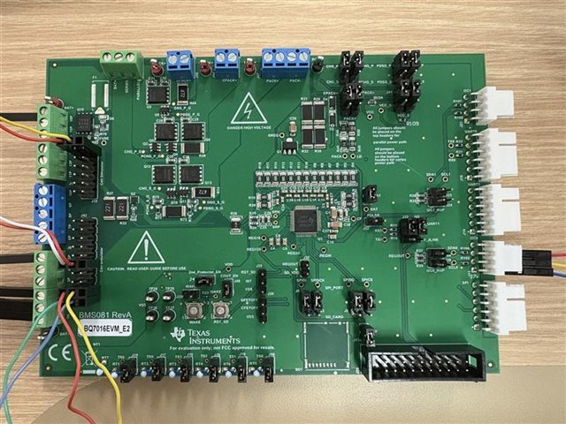

  • Hello HJ_KIM,
    After reviewing the video the biggest issue is that your gauge isn't automatically being connected to BQstudio meaning there is a setup issue with your board. Just to confirm for the shorting portion of the voltage taps of the empty spots did you do a solder bridge? In the earlier picture you sent it seemed that is how you shorted the voltage taps.
    Thank you,
    Alan
  • Hello Alan
    The first photo is J33 and J42 shorted, and the second is shorted directly by Lead wire. I'd appreciate it if you could tell me which one is the right way.
    If J33 and J42 are ordered to SHORT as jumpers, please check whether the connected one is SHORT or OPEN one is SHORT.
    Thank you
    HJ
  • The latest firmware bundle only includes the .enc.bq.fs file, which is not compatible with EV2400.
    Could you please provide an unencrypted .bq.fs file (e.g., bq41z90_v0_01_build_1.bq.fs) that can be used with bqStudio’s Programming tab?
    Thank you in advance.

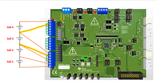

  • Hello HJ_KIM,
    the cell simulator can only be used by itself and not with a cell hooked up with it. If you are hoping to test your cells with it than it would be best to remove the jumpers and solely use the voltage tap connections. Also if you are doing a 4 cells in series connection I've attached a diagram to do so. The ones highlighted orange and green represents the wire connection and yellow highlights means optional wires.
    Thank you,
    Alan

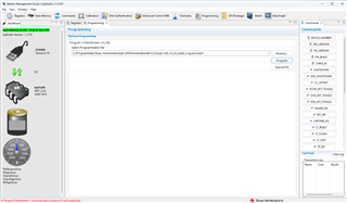

  • Hello Alan
    Thank you very much for your kind reply.
    However, the current problem seems to be a problem with communication regardless of cell connection.
    When I connect to the I2C with the EV2400, it seems that I2C communication is available as shown in the attached picture. However, when I tried to program, the message "Program Flashstream: Communication protocol is not supported" appears in the bottom left. I will summarize the questions below.
    1. Is it impossible to program with I2C?
    2. Why is SMB not communicating?

  • Hello HJ_KIM
    Firmware development for bq41z90 is an ongoing process, at the moment the current FW version of BQ41z90 does not support i2c, currently there is no time table for when the next fw update will be released
    -This is most likely due to your hardware setup being down incorrectly. Please reference the EVM For help on implanting the battery gauge.
    EVM:
    https://www.ti.com/lit/ug/sluud64/sluud64.pdf?ts=1745615153865&ref_url=https%253A%252F%252Fwww.ti.com%252Ftool%252FBQ41Z90EVM
    Thank you,
