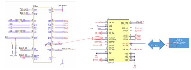

I am looking for CC CONTROLLER for TUSB564.
I'm trying to use a TPS25730.
Can I use it as shown in the picture below?
How do I connect to HPD on a TUSB564?
Hi Jun,
The TPS25730 can support plug_flip, but does not support DP Alt mode and therefore is not suitable for pairing with the TUSB564. We do not have a recommended PD controller for DP alt mode at this time.
