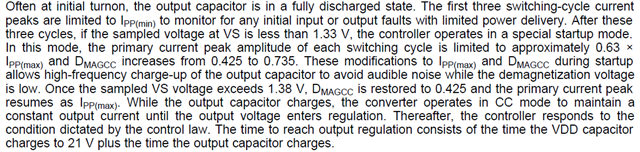

  • IVSL(STOP) as 80 µA and IVSL(RUN) as 225 µA refers to VS pin for OVP and input UVLO protection. It has nothing to do with CS pin protection. The CS protection threshold is 1.5V and it is not filtered by LEB. (page 13 in datasheet).
    Please read this paragraph for start up sequence.
    Q3: yes
    Q5:yes, it is just a ratio as shown below.

    Stop needs 3 consecutive cycles below 80uA. start up will also check if current is above 22uA for 3 cycles before true start up
    4) We interpret this as continuous analog monitoring rather than a single, discrete sampling point per switching cycle
    The logic (comparison) will be done at the end of the cycle (when on is end) but the current is continuously compared.
    Q2: the switching freq is no fixed during start up. Please read the start up section in the datasheet. Under normal operation, you can follow the control law diagram in figure 15.

    • If the current coming out of the VS pin is less than IVSL(run) during FET on at startup the design will go into under voltage lockout mode. (IVSL(run) = 225 uA. Please note excessive ringing during this time could cause this to shut down to UVLO.  This also can be removed with snubbing.
    Q2.
    On page 16 of the datasheet (CV mode operation), please indicate the switching frequency (fsw) when the peak current Ipp equals 1/4 of the maximum Ipp.
    • When the controller is operating below 32 kHz the peak current will be controlled to ¼ the maximum.

    4) In our testing, the oscillation stopped when the CS pin was falsely detected and the FET was turned off immediately after the LEB period. This behavior is unexpected for an IC, but can the IVSL monitor the correct value in this case?
    It takes 3 faults to turn-off the IC not just one.  Application note SLUAAC5 will give you guidance on how to resolve these issues.  I also made recommendations above.
    5.) The following is an excerpt from SLUAAC5.
    'The Vaux ringing in Figure 8-1 is excessive and rings down below ground during tLK_RESET. This behavior is known to trigger a UVLO faults and shut down the converter. This is because when the VS pin crosses ground it activates input UVLO fault.'
    The above "UVLO faults" are IVSL (STOP) = 80uA, but doesn't IVSL monitor when the FET is ON?
    It does not matter if the FET is on or off.  If the aux winding signal rings below ground when it should not the controller will misbehave and shut down.
     Isn't the FET off in the above state?
    The FET could be off or turning off.
