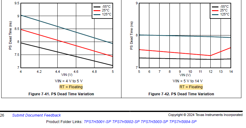

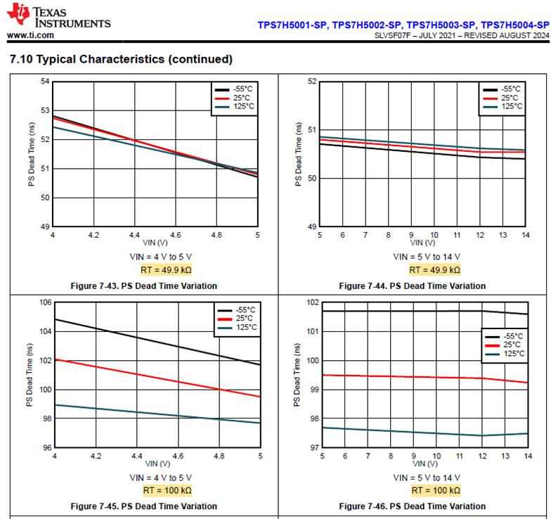

Dear E2E Support,
Could you confirm there is no way to get a dead time upper than 255.89ns with a Rps=Rsp value of 300kohm?
There is also a misunderstanding in the graph page 26 and 27 of the datasheet: is there really a link between the frequency settings (via RT) and the dead time value, or is it a typo error (RT to be replaced by Rps=Rsp)?
    I can confirm that the RT in the graphs should be SP/PS and this is a typo on the datasheet.
    You may be able to get higher dead times with larger SP/PS resistances, though we have not tested beyond the numbers of what is in the datasheet, so its at your own risk.
