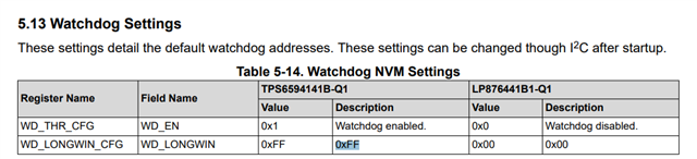

    Q5: what is default setting status of watchdog, disabled ?
    Q6: can we use watchdog output EN_DRV to reset SoC system?
    In TPS6594141BRWERQ1 device, the internal Q&A watchdog is enabled by default and once the device is power up into ACTIVE state, then it can be configured for the trigger if the Q&A is not required.

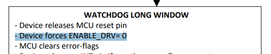

    currently EN_DRV goes low right away as long as system bootup, how can I get EN_DRV low immediately if the default is long window 772 seconds by default?
    I used all default settings for both PMICs

  • more questions about TPS6594141BRWERQ1
    Q1:I tried to disable the watchdog via GPIO8 high on TPS6594-Q1, but EN DRV still output low, is there something else I have to clear in order to get EN DRV high? Or EN DRV has to be set high by MCU only, it cannot be high by disable the watchdog ?
    Q2: Watchdog default mode is Q&A mode, enabled, long window , correct?
    Q3: what is the long window default value: 772 seconds?
    Q4: can long window value be changed in initialization and new value stored in NVM?

    how much is the long window time?
    That means maximum time which is approximately 12 to 13 minutes.
    In the long window the EN_DRV goes to low by default. Please see the WD flow diagram in data sheet.
    The EN DRV needs to be set HIGH by MCU. I have already explained in the answer of first question above.
    This is mentioned above.
    Yes

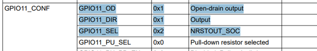

  • how nRSTOUT links to GPIO11 and GPIO_OUT_2 ?
    can we have a call for this topic?
    Max
  • Hi Chen,
    I miss understood, since there is SoC NRSTOUT as well which is configured  in GPIO11.
    But if you meant nRSTOUT (pin 25) , then that is meant to be used as MCU reset or power on reset output . This is Active Low and open-drain configured.
    This would also have the similar behavior as of NRTOUT_SOC signal. Inactive means HIGH and Active means LOW.
    I hope this clears the misunderstanding.
