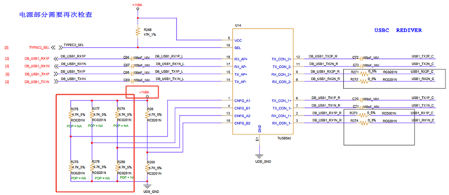

Hi Kailun,
Apologies for the delay, here is the schematic review:

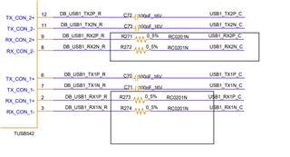

1) Is there any additional AC coupling on these paths? I see that this connects to the FPC connector, but I cannot see the path from the FPC to the MB.
2) I recommend having some filtering on the power to reduce power plane noise coupling: (recommendation 1x 10uF, and 1x 100nF)

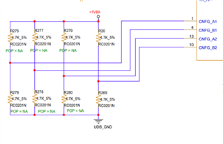

3) Tri-level CFG pins all have PUP and PDWN options allowing for 0,F,1. OK
4) TX pins go through 100nF capacitor, to 220k PDOWN (no pop), to PESD5V0R1BSF, to connector. OK
RX pins go through 0ohm resistor, to 220k PDOWN (no pop), to PESD5V0R1BSF, to connector. OK

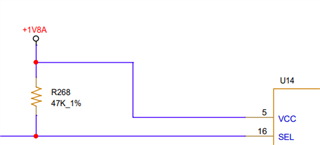

5) Sel will be controlled by a signal form the FPC conn. no need to connect to 1.8V
