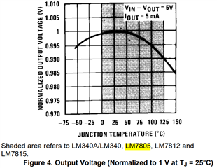

Datasheet only specifies operating conditions from 0C and above.
Can this part be used in industrial applications below 0C? What's the approximate behavior degradation expected?
  • Hi Joey,

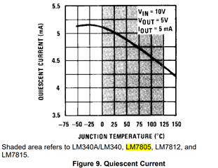

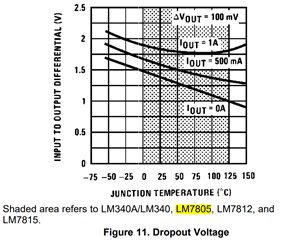

    It won't damage the device, but it is out of recommended range, so the EC table values will no longer be guaranteed. Basically, expect lower output accuracy, higher quiescent current, and higher dropout per a number of graphs demonstrating typical behavior below the 0'C limit that can be found in the datasheet:
    If you're expecting a subzero application, we can always find you a similar part designed to work more reliably in those conditions.
