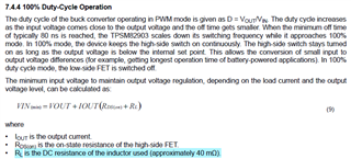

  • Hi Colin,
    The DCR is stated to be "approximately 40mΩ."
    Does this mean that if I use an inductor of less than 40mΩ with the TPS62903, the TPS62903 will be more efficient?
    Dice-K
  • Hi Dice,
    Yes, you are right.
    COlin
