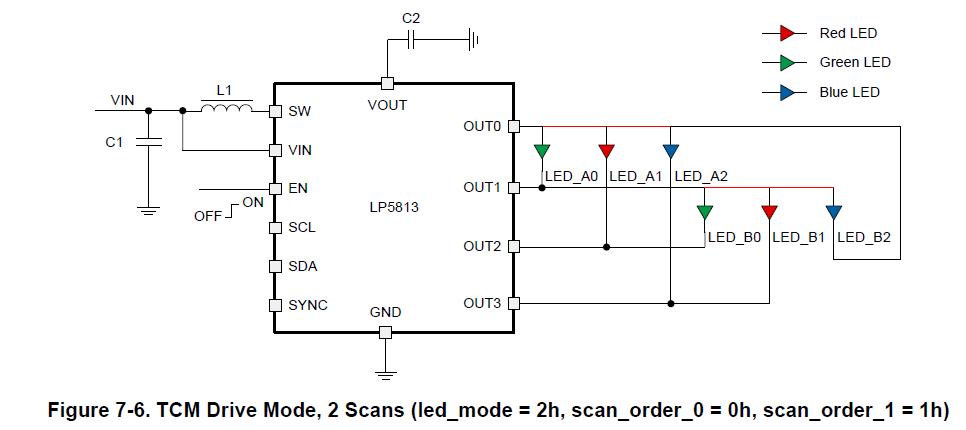

  • Hi Kyohei,
    LP5813 can be configured as below to support 6 LEDs with max 25.5mA average current per led and individual control.
    Felix
  • Hi Felix,
    My customer is considering using the LP5813 for 6-channel individual control.
    The usage involves two circuits, each lighting up R, G, and B LEDs respectively, making a total of 6 LEDs (3×2).
    The method is to light up R → G (R off) → B (G off) → R (B off) in microseconds.
    The current values are not changed from the initial settings.
    Additionally, the current values for each RGB LED are different.
    When using the LP5813 in matrix control, is it possible to individually control 6 channels with different current values for each LED?
    Kyohei
  • Hi Kyohei,
    Yes, the maximum current and pwm value of each dot can be controlled individually through corresponding separate registers.
    Felix

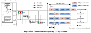

  • Hi Kyohei,
    Yes, the 6 LEDs can be turned on "simultaneously".
    Yes, use PWM.
    Though, in reality, the 6 LEDs will be lighted up in turn (LED_A0/1/2 to LED_B0/1/2 to LED_A0/1/2 to...), but the scan frequency is relatively high that is 24KHz. As a result, it appears lit to the human eye.
    Felix

  • Hi Kyohei,
    No, the analog dimming is modifying the maximum current but as the LP5813 works in 2 scans mode, so the LEDs on the two scan lines (OUT0 and OUT1) still light up in turn.
    Yes, the LM3535 is a recommendation. LP5569 is another recommendation, which has the animation engine control function as LP5813 has.
