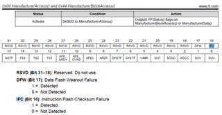

We have been notified of existance of a IFC(Instruction Flash Checksum Failure ) in one of our e-bike product after a couple of usage in the field. This is the first time we faced with this failure , which is seen only at one product.

Information about Gauge IC , system status and logs taken from faulty system is listed below. This logs are read from Gauge IC by E-bike battery MCU and formatted accordingly.
Gauge Hardware : Bq78350_R1
Gauge Firmware Version : bq78350_R1_v1_04_build_26 1.srec
Permanent Failure
0x10000

    The IFC failure in the BQ78350-R1 is not entirely random but is often tied to underlying issues with the flash memory or firmware execution. Based on my knowledge of BMS systems and the BQ78350, the IFC failure typically occurs when the gauge detects a mismatch in the instruction flash checksum, which can happen due to Flash Memory Wearout, Power Supply Issues while flashing the device, Electromagnetic Interference (EMI) can interfere with flash operations, leading to corruption.
    Even in an ideal implementation (i.e., operating within specified voltage, temperature, and current limits), the IFC error can still occur.

  • Dear Mr.Couso
    Thank you for your response. We had an opportunity to read written gauge firmware on the faulty device. It seems that some part of the gauge firmware is deleted and 3 bytes from random location of firmare does not match with the original firmware (bq78350_R1_v1_04_build_26 1.srec provided at the TI web page).
    From my analysis R1 firmware did not indicated a false positive in this case.
