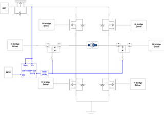

We are planning to use LM74502H-Q1 in one of our applications.
We will be controlling two different circuits of back-to-back N-channel FETs.
So we can not connect the common Source of back-to-back FETs to the 'SRC' Pin because of the two separate circuits.
Please advise if we can connect the SRC pin to VS or GND for normal operation.
Looking for a prompt response.
Thankyou in advance.
