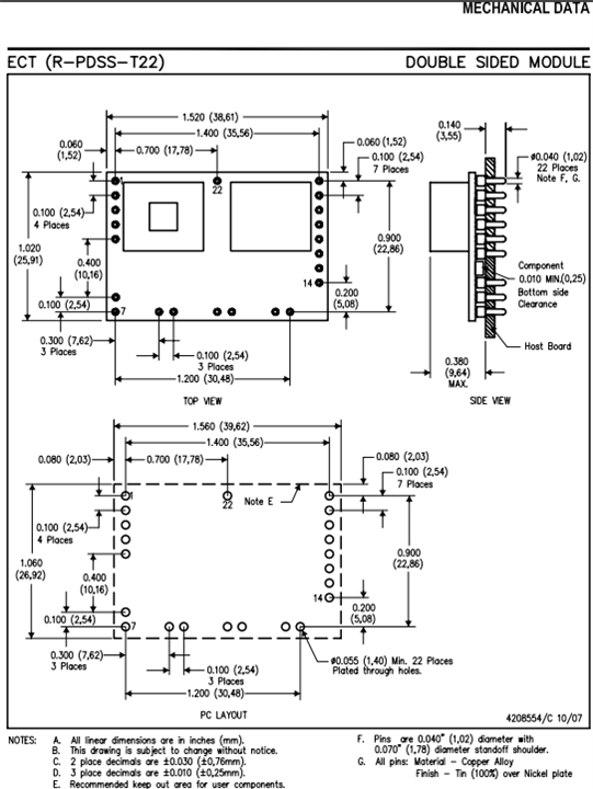

Hi Team,
There are no information about the differences between AD(PTH08T210WAD/250WAD) and BD(PTH08T210WBD/250WBD) in the datasheet of PTH08T250/W and PTH08T210W. I think that the status of BD version is EOL. Please let me know the differences between both.
