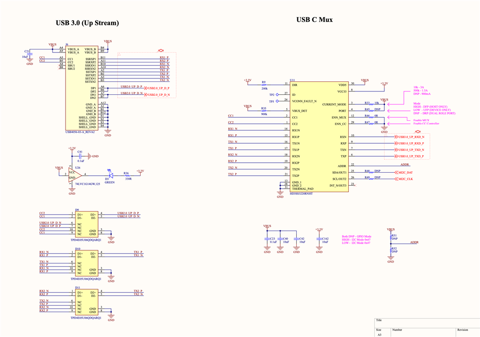

we had troubles with cable orientation so we added HD3SS3220 and it resolved our issues.
After testing our product with older devices, we noticed that on our Macbook Pro 2017 our USB Hub always gets recognized as USB2.0. If we connect our first prototype without HD3SS3220 it is identified as USB3.1.
Is it possible that HD3SS3220 needs a special configuration to support older USB3 ports?

    Could you provide the schematic for your HD3SS3220 design? I would like to review that and make sure everything is setup properly.
    The HD3SS3220 shouldn't have any issues with supporting older USB3.0 ports, so long as there is proper communication between the CC lines and the ID pin is correctly routed to allow VBUS to be sent only when the ID pin is low.

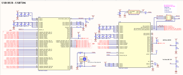

  • Hello Ryan, thanks for your reply.
    Here are our schematic.

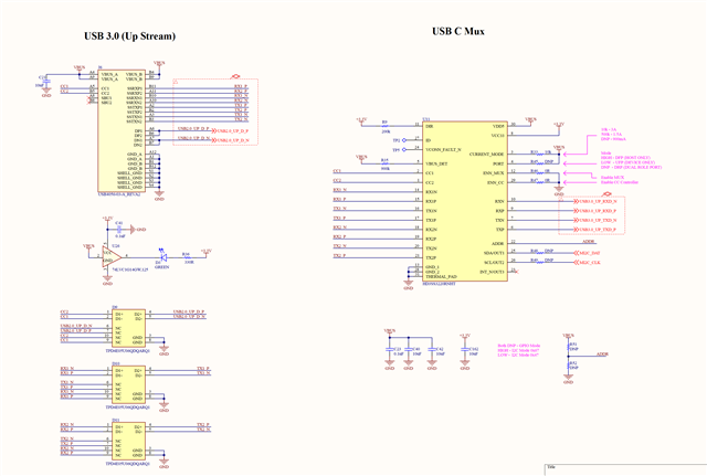

  • Hi Kornel,
    I can see them now, thank you!
    Looking at the USB3 data lanes, I don't see any coupling capacitors on the TX lanes of the mux. Are these on a different part of the schematic? There should typically be 100nF or 220nF capacitors on TX lanes of the device, as the RX lane should already be coupled by whatever is connected upstream from the device.
    I see you have the port pin floating for DRP, are you seeing this issue when both set as a UFP and DFP, or just a certain orientation?
    For a DFP connection, the ID pin must be connected to something externally, like a voltage/power switch or GPIO of a host in order to enable indicate when VBUS should be supplies during the CC pin communication. If VBUS is supplied at all times during communication, the CC pin negotiation will fail, and cause issues with completing a USB3 connection.
    Also, monitoring the DIR pin when you flip the type-C cable can help determine if the CC negotiation is being completed successfully or not, as the DIR pin should change depending on the orientation of the cable.
    Please let me know if you have any other questions.
    Ryan

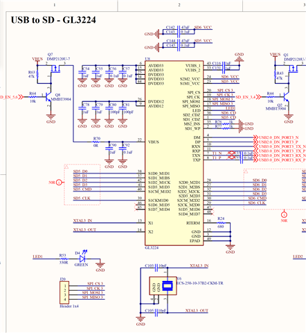

  • Hi Ryan, thanks for your reply.
    Our TX lanes are connected to a Microchip USB7206 Hub from there to GL3224 Memory card controller. We have coupling capacitors 0.1uF between the USB Hub and MCC.
    We configured the HD3SS3220 on UFP today but it still don't work on the Macbook Pro 2017 Model. On other devices it works just fine as on DRP.

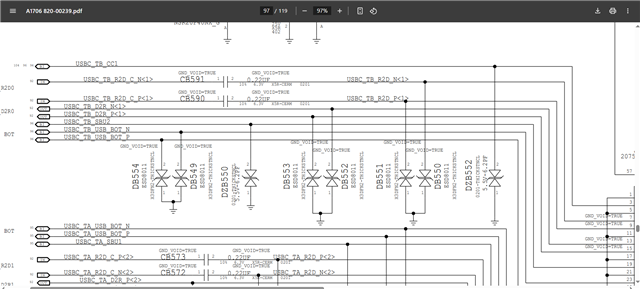

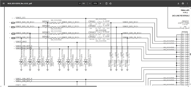

  • Hello Ryan,
    We found out that if we plug an external USB-Hub between the Macbook and our board it works correctly. So the negotiation between our board and the USB-Hub works properly and the USB-Hub negotiates correctly with the Macbook.
    We checked the schematics of the problematic Macbook Pro model and noticed that other models have additional capacitors on the TX/RX lines.
    We also found in the instruction (https://www.ti.com/lit/an/slaae24/slaae24.pdf?ts=1744138419755) - Page 7 - that the placement of the capacitors is relevant.
    Since our board has capacitors right before the Multimedia Card controllers, which by default are off, but no capacitors between the USB-C Plug and the MUX nor the MUX and the USB-Hub controller can this be the cause? Should we add additional capacitors earlier?

  • Hi Kornel,
    It sounds like the issue might be capacitance then, I believe.
    Is this schematic for the working model? It looks like for this one, the main difference is that they have the 330nF caps on the RX lines, which helps with interoperability with devices that might have varying amounts of capacitance on the line, ensuring they stay within the range specified by the USB3 spec.

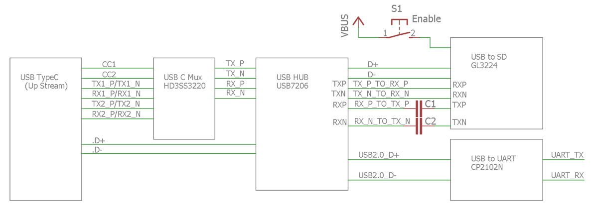

    Could you make something like a block diagram for what the expected setup is for your system? I.E What devices the USB3 signals goes through from host to device? It may be possible that the signal is going through a device, like a redriver or something similar, which intakes the signal but does not recouple the signal. The TX lines of the USB3 signal always needs to be coupled with either 100nF or 220nF capacitors, and will need to be recoupled if it goes through a device which removes the AC coupling.
    Just to confirm, does the upstream port connect to the macbook? If you board is connected properly, should the macbook detect a USB3 connection when your board is connected, or does another device connect to the macbook through your board?
    Ryan

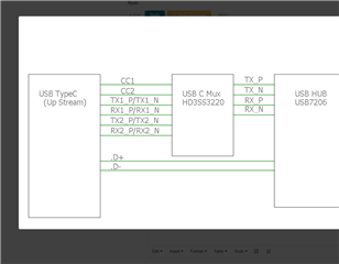

  • Yes the mentioned schematic by you is from a working model.
    Attached is a block diagram of our setup.
    Kornel
  • Hi Kornel,
    In this segment of the block diagram, going from the TX of the hub to the TX of the type-C port, are there any 100-220nF capacitor coupling the TX lanes? I don't believe I saw any in the schematic, though I could be missing it. If the TX lanes are not being coupled between here, I believe that would explain why the Macbooks with the 330nF caps on the RX lanes have better performance.
