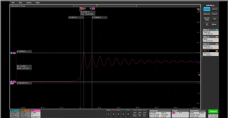

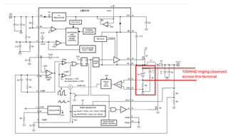

Hi Yash,
This is regarding MPN -  LM5118MHX/NOPB. I have some queries, please find the below list
  1. Please refer the below image, In the highlighted area I am seeing 100MHZ ringing  while measuring voltage across diode, so to mitigate this ringing can you please confirm the snubber should be placed across diode or diode w.r.t ground(as placed in below image). Please help me to understand what is the reason for this ringing
