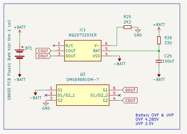

I've designed an UVP/OVP circuit to protect the 18650 lithium battery. However, I'm struggling to make it work.
The schematic looks something like this:
After placing the battery nothing happens. However, placing the multimeter between GND and G1 of the DMG6968 the FETs seems to start conducting and everything works. Is this because of the gate threshold? VGSth is 0.9V maximum, so I guess no...
Any suggestion? What could be the issue here?
