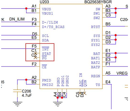

Hi team,
Could you advise what PINS of nINT/STAT should connect to MCU? Thanks.
Hi team,
Hi Kailun,
The /INT and STAT are digital signals.
The INT output immediately notifies the host when a fault occurs or status changes.
The STAT output reports the charging status and any fault conditions.
Thanks Shuvam,
Another quick question: Can the 100ohm resistor between BAT and BATP in reference design be canceled?
Hi Kailun,
No that is an important resistor and used for sensing the battery voltage accurately. It is not recommended to keep BATP pin open.
