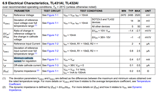

    I see that in the diagram you are using the TL431 and not the TLA431. Are you seeing the 650uA behavior on a physical board, or via this simulation?
    Depending on which TL431 device is used, Ika_min behavior is consistent with the datasheet. For example, please see the Ika_min for the TL431AI device below:
    I hope this helps!

    Thanks for the update!
    The IKA_min (max) specification should hold for any situation.
