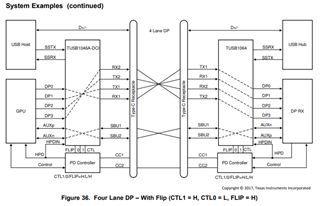

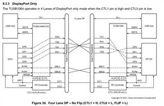

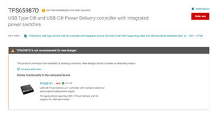

Good afternoon, we are planning to use TUSB1064 in our project. Please recommend a PD Controller that is best paired with the TUSB1064 and with CTL and FLIP control. Is it possible to use TUSB1064 without control from PD Controller on CTL[0:1] pins, but to set it by resistor pull-up to the required mode? Thank you.
