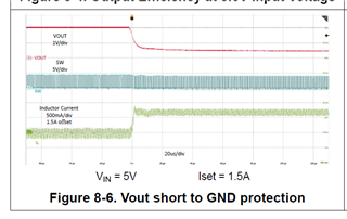

What is short circuit limit on output pin (When VOUT is shorted to GND) of TPS92201AEVM.
