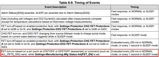

  • Hello Vladislav,
    Correct.
    This is in the TRM:
    Luis Hernandez Salomon
  • Hello Luis,
    Thank you for the screenshoot. Could you clarify, do this 250ms happens only in case of CFETOFF/DFETOFF/command case?
    If BQ decides to turn off MOSFETs on his own, does this delay happen?
  • Hello Vladislav,
    The case highlighted is solely for turn-ON, not turn-off. Turn-off will be very fast. In this case it is saying that if you deassert CFETOFF/DFETOFF, it may take up-to 250-ms for the MOSFETs to turn back on.
