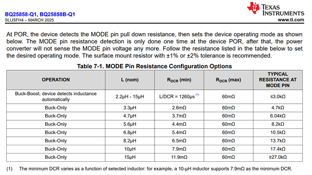

Considering these ICs for a Buck/Boost design, and am challenged by Table 7-1. MODE Pin Resistance Configuration Options.
Comment 1 appears to indicate a minimum DCR regardless of whether it is buck/boost or buck only.
Can you confirm If i am looking to operate in buck/boost that minimum DCR for a 10uH inductor must be 7.9mOhm, or does this only hold true for Buck only mode?
The Ideal inductor I've selected for the circuit is ~2.6mOhm DCR and I'd like to run this in buck/boost if possible.

    7.9 mOhm would be the minimum DCR for the 10 uH inductor for both buck-only and buck-boost modes. The formula given for buck-boost R-dcr is how the buck-only values are calculated.
    • L / DCR = 1260 us
    • DCR = L / 1260 us
    • DCR = 10 uH / 1260 us = 7.9 mOhms
    The inductor you have selected will unfortunately not be within the accepted DCR range for this part. Let me know if you have any other questions.
