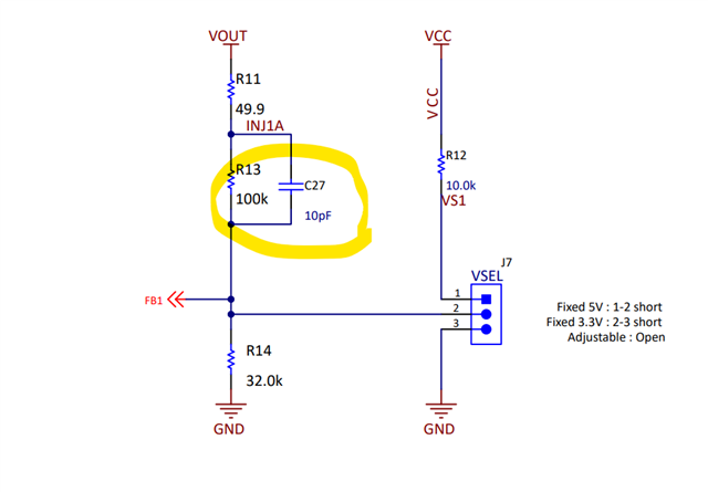

Hello team,
Can you explain why Cff is paralleled with 100kohm? Also, why 150kohm is divided two resistors?

Hi Austin,
The Cff is placed in parallel with the top feedback resistor (100kOhm) to optimize the transient response.
The additional 50Ohm is an injection resistor we use to do a bode plot on the board.
