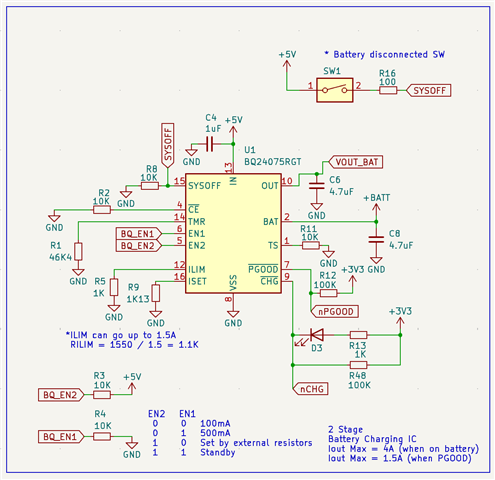

Hi guys,
I've been working on a gateway that should work based on solar panel recharging.
I've been switching between different IC's and my latest design is with the BQ24075. I wasn't able to fully tested it yet, but so far it seems to work ok. I plan to do deep cycles this week but so far the schematic looks something like this:
I'm using the AP63205WU buck to regulate the input voltage from the solar panel to 5V and then sourcing it to the BQ24075. I've noticed already that probably instead of connecting BQ_EN2 to +5V I should have connected it instead to VOUT_BAT. But besides of that, anything else that pop's out?
nCHG is going low level even without the battery connected. However, activating SYSOFF by swathing SW1 makes it high level again. Is this the expected behavior? I'm bypassing BAT pin with a 4.7uF capacitor.
One last question, the BQ24075 will not protect the battery right? I still need to use a OVP and UVP IC right?
Thanks in advance,
Fernando Fontes
  • Hi Fernando,
    I've reviewed your schematic and it looks good. I agree that it would be better to connect EN2 to OUT if you intend for EN2 to always be pulled high. Other than that, I don't see any issues.
    Since you're using a solar panel input, I recommend considering an alternative approach: connect the solar panel directly to the charger and utilize the charger's input voltage dynamic power management (VIN-DPM) feature.
    VIN-DPM is active when EN2=0, EN1=0 or EN2=0, EN1=1. This feature prevents the input voltage from falling below the VIN-DPM threshold (4.5V) by dynamically reducing the input current limit, which is particularly useful when using high-impedance input sources like solar panels.
    Refer to Table 9-2 in the BQ2407x datasheet. The /CHG output is expected to be high-impedance when the battery is disconnected.
    Could you provide more details about this behavior? Is /CHG flashing or staying low?
    The BQ24075 does not include battery OVP or UVP protections. I recommend using a battery protector IC to implement these protections.
    I also recommend checking out the BQ25185. It's our newest standalone linear battery charger and includes battery-tracking VIN-DPM and offers several integrated protections, such as battery undervoltage protection (BUVLO).
    Additionally, here's a useful article: Using Battery Tracking VINDPM to Make the Most of Solar and High-Impedance Power Sources
    Alec
  • Hi Alec,
    Thank you for the reply.
    So, I thought that ENx pins were being used for limiting the input current. My idea was to have the maximum possible current on the output even without a battery connected, since I will also want to use this gateway indoors, connected directly to a 12V transformer. In this case, you are saying that the DPM feature will not work? And the battery will continue to be charged normally (at 1A) even if the system voltage is dropping?
    Also, related to your suggestion, the solar panel that I'm planning to use is rated to 12V but can go up to 18V. From the datasheet, the operating voltage range is mentioned to be from 4.35V to 6.4V. So, I guess that the battery would not be charged until the voltage of the panel dropped for such range right? That's why, I've used the 5V regulator, to be able to use 12V solar panels and still charge the battery all the time. Since I also want the gateway to work indoors without the battery, I've picked the '05 version to have the SYSOFF pin.
    Any suggestion that could work better here? Is the BQ25185 a better candidate? The gateway itself will drive a 4G simcom module while also powering some external sensors.

  • Hi Fernando,
    Thanks for the updates.
    Yes, you're correct that the ENx pins are used to configure the input current limit mode. Just to clarify, VINDPM and DPPM are different features.
    VINDPM (input voltage dynamic power management) prevents the input voltage from dropping below the VIN-DPM threshold (4.5V) by dynamically reducing the input current limit. This is useful when using weak USB sources or solar panels. On the BQ24075, this feature is only active for the previously mentioned ENx modes. See section 9.3.4.1.1 of the datasheet for more details.
    DPPM (dynamic power path managament) reduces the charging current when the system voltage falls below the VDPPM threshold due to the sum of the charging and system currents exceeding the input current limit. See sections 9.3.4.1.2 and 9.3.4.1.3 of the datasheet for more details.
    Yes, you are correct. The BQ24075 input overvoltage protection is 6.6V (typical), so the battery won't charge when the input voltage is higher than this threshold. In that case, using the 5V regulator is a solid approach.
    The BQ25185 is our newest standalone linear charger and supports input voltages up to 18V, so you wouldn't need the 5V regulator.

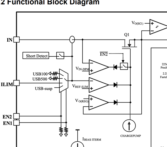

    I've checked the input voltage and it seems that somehow the 5V line is not going to 0V, is it possible that BQ_EN2 is somehow pull-up internally and is making the 5V line go battery level?
    EN2 is internally pulled down. See the functional block diagram of the charger in section 9.2 of the datasheet. Could you monitor the input voltage on one of your scope channels?

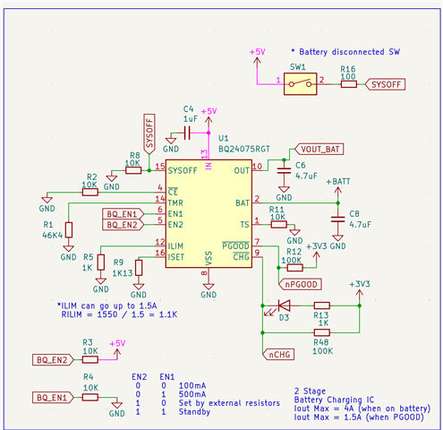

    After taking another look at your charger schematic, I realized that SYSOFF is connected to +5V through a switch.
    SYSOFF is internally pulled up to VBAT through a large resistor (~5MΩ), which could be related to the behavior you're seeing. Is the switch closed when you see this behavior? From the second waveform, it looks like +5V is around 4V, which I expect is your battery voltage.
    I don't see any obvious issues with the circuitry around Q1 in your buck-boost schematic.
    Let me know if you have any updates.
    Alec
  • Yes, you're correct. The input source will be able to supply the system load even when no battery is connected.
    If you need to disable charging while the battery is connected, you can use the /CE pin.
    The BQ25185 also has factory mode (similar to ship mode on our other chargers), which is an ultra-low-power mode where the battery is disconnected from the system. This mode can only be entered when no input source is present and is exited automatically once an input is connected.
    I will change the schematic and then I will ask your revision if that is ok.

    Is this intended behaviour? I guess that in the diagram block of the BQ2407x Q1 is probably being activated?

  • Hi Fernando,
    Yes, feel free to share your updated schematic and I will review it.
    The switch was open... Today the issue was happening but only for a few seconds. I've removed Q1 just to be sure and I've also connected BQ_EN2 to VOUT_BAT. R16 was also removed. The only connection to the 5V line is now the IN pin (number 13).
    I've attached to videos, one that shows the /CHG led and another one that shows the 5V line. As you can see, when I turn off the external power supply the 5V line immediately drops to the battery voltage ~4V. Then it takes ~3 seconds and drops to almost 0V. At that point the LED goes off.
    The input FET (Q1, simplified in the functional block diagram) blocks reverse current from the output to the input, so I wouldn't expect the battery to be charging the input capacitance.
    That said, it seems likely that the input caps are discharging too slowly after the input source is removed, which could be causing the behavior you're seeing.
    You could try placing a resistor from VIN to GND to help them discharge more quickly and see if that changes the behavior. This can also help rule out the possibility that the battery is somehow back-powering VIN.
    It appears that your battery is not connected when this behavior occurs. Are you powering BAT using an external supply?
    Alec

  • Hi Fernando,
    I'm happy to support.
    Thanks for sharing your full schematic. I've reviewed it closely but still don't see any obvious paths from the battery to the input of the charger.
    To help fully isolate the issue, could you try disconnecting all components that might be creating an unintended path from BAT or OUT back to VIN?
    Please desolder the following components:
    - TPS63020
    - TPS55165
    - AP63205
    - Q1 (the PFET)
    Then, please cut the trace or pour going to VIN (+5V) of the BQ24075, and solder a wire to the input cap (C4) so you can apply external power directly to VIN.
    This setup should leave only the BQ24075, with BAT connected to the battery and VIN floating unless driven by your external supply.
    If battery voltage still appears on VIN with nothing connected to it, that would suggest the conduction path is internal to the charger. If not, then the path is likely coming through one of the removed components or associated traces.
    Also, have you been able to replace the charger IC to see if that resolves the issue?
    Alec
  • Hi Alec,
    Ok, Monday I will do the experiment.
    No, unfortunately I don't have more ICs in stock. But will order some and try again.
    Fernando Fontes
  • Hi Fernando,
    Sounds good, just let me know what you find.
    Alec
