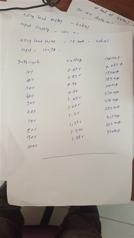

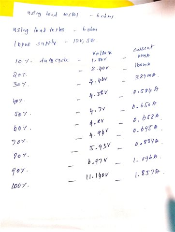

    We are unable to capture all the waveforms at the moment due to issues with our oscilloscopes, until we fix that we have taken the current ratings for various PWM duty cycles. Do you see any issues ?
    Electronic load tester is used at 6ohms resistance mode
    12V is the input voltage, let me know if you see any issues.
  • I would suggest monitoring the waveforms with oscilloscoper.
    The current is set to over 3A, with 6 ohm load, the device will run into dropout mode that output voltage charged up to input voltage.
  • Hi, thanks for the reply. Can you please suggest me what should the electronic load setting be?? I mean what should the resistance setting should be for the testing purpose?
  • With 3A 6oHm, Vout = 3*6=18V, which is over 12V input. The device won't deliver the target current as expected.
    You may use LED or constant voltage output or lower load resistor value to < 3ohm etc.
    If you can monitor waveform with oscilloscope, then you can better understand the operation condition.

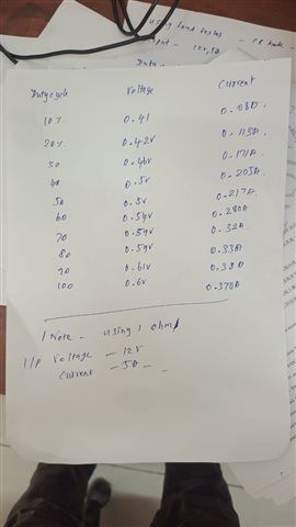

  • We have tested with some extra load values less than 3 ohms and looks like the values are still odd. Can you check please?
    Constant resistance 1 ohm as load
    Constant resistance 2 ohm as load
    We are planning to connect a couple of LED's to the board and see if the circuit works. Do you think as per the existing circuit diagram I shared earlier the circuit is safe to be connected with LED's? What is the typical setup TI uses to validate current drivers like this using electronic load testers?
  • Would you pls kindly use oscilloscoper to capture waveforms? For example,  VIN, VOUT, COFF, switch node voltage, and inductor current?
