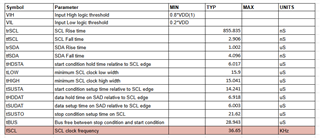

Dear TI Expert,
We are currently using the BQ76940 AFE in combination with the BQ78350-R1 companion IC. As per the BQ76940 datasheet, the I²C clock frequency is expected to operate at 100 kHz. However, during practical measurements, we are observing a frequency closer to 36 kHz.
Could you please clarify:
  • If there is a recommended method or setup for accurately measuring the I²C clock frequency?
  • Whether this variation in frequency is expected under certain operating conditions or configurations?
