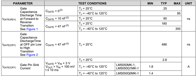

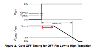

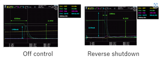

We are currently working on a design using the LM5050.
Regarding the gate OFF timing when transitioning from forward to reverse and when the OFF pin transitions from low to high,
Could you please tell me the maximum values ​​of tGATE(REV) and tGATE(OFF) when measured under the following conditions?
[Measurement conditions]
・tGATE(REV)
 25℃
 VGS:4.32V
・tGATE(OFF)
 25℃
 VGS:3.44V

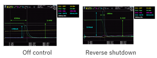

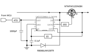

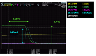

For reference, we have attached the circuit diagram and the waveforms we measured.
Circuit Diagram
Gate OFF Timing for OFF Pin Low to High Transition
Gate OFF Timing for Forward to Reverse Transition
If there are any similar examples please provide a link.
