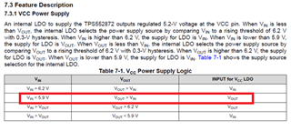

    1. I know VCC output is 5.2V , If the input voltage down to 4.5V , What is a VCC output? Is there a bypass function input to output?
    2. Once input voltage is 4.5V and output voltage is 6V , VCC power supply is Vout. Is it right?
      - If yes, When the customer directly connect MODE to VCC, FPWM function operate well?
      - First, If the input voltage 4.5V is injected, VCC power supply is Vin => regulated 6V output => VCC power supply switch to Vout. Is my understanding right?
    Thank you.
  • Hi Dino,
    Do you mean during start up, Vout is not ready? VCC will directly be powered by Vin and it is 4.5V.
    Yes. when Vout reaches 6V, VCC will be powered by Vout and output 5.2V.
    The mode pin high voltage threshold is 1.2V. So FPWM function is ok.
    Before Vout reaches 4.5V, VCC=Vin=4.5V. When Vout reaches 4.5V, VCC will follow Vout, ramping from 4.5V to 5.2V. When Vout exceeds 5.2V, VCC will be stable at 5.2V.
