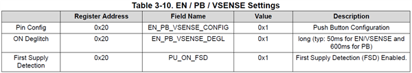

Customer reviewed TPS6521910RSMR TRM, there are some NVM default settings regarding PMIC ON/OFF control and RESET need further clarifications as followers.
  • Pin-25 “EN / PB / VSENSE”
  • Why this pin be config to push button as default?
  • Any specific applications that AM67x focused need push button for power ON/OFF controlling by manual operation (press and hold 600ms)?
  • FSD be enabled as default. Does it mean PMIC will AUTO power ON without long pressing bush button once power valid first time?
  • If sudden power loss appeared during power ON procedure, any backup mechanism for fail recovery to prevent PMIC stuck?
  • Is it possible to re-program this pin to be EN as default?
  • If this pin be config to EN as default, then EN be transient from HIGH to LOW would enable PMIC internal discharge circuit (supposed it had) on each power rails or not?

  • Hi Rich,
    - I need to find out the reason behind configuration to PB.
    - yes, when FSD is enabled, PMIC will ignore EN/PB on the first power up and as soon as VSYS ramps up, PMIC starts to power up.
    - If the power up sequence is not complete, PMIC will initiate a power down sequence and pull down on the output rails will be engaged to discharge the outputs.
    - Yes, thru NVM programming, it can be changed from PB to EN.
    - Correct, when EN goes high to low, it will start power down sequence and discharge resistors are engaged.

  • Hi Sathish,
    1. Any update of PIN-25 be PB as default setting?
    2. In theorem, cold reset will have better false recovery comparing with warm reset due to full power cycle be done properly. If internal state machine be stuck and all power rails still be kept, then it may be suffered boot up fail once again.
    3. Owing to FSD in NVM default be enabled upon programmed PMIC, it should go power ON procedure once power supply be valid rather than NVM programming process. In this situation, IN CIRCUIT NVM re-programming is workable or not?
    4. If not, any suggestion to make it works?
    Jones
  • Hi Jones,
    1. i am not sure about why it was chosen like that, may be requirement from SoC.
    2. For AM62x only required a warning so it was set to warm reset.
    3. When FSD is enable, PMIC will initiate the power up routine as soon as VSYS reaches expected voltage. And, NVM can be changed after that.
