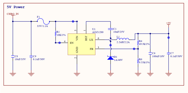

Dear TI team,
I hope you are doing well. I have attached my schematics for the BQ25185. I am facing the issue that the battery is not being charged according to the ISET value, which is 300mA. My LiPo battery is at 3.7V, and the charging current fluctuates from 70 to 160mA. I am measuring the current through DMM.
Everything is working according to the datasheet except the charging current. Please also point out any mistakes in the design, if there are any.
Please provide instant support on this matter.
I am looking forward to hearing back.
Ahmed Ali
Also, check the circuit for +5V to see whether it is okay.
  • Hi Ahmed,
    I've reviewed your BQ25185 schematic and it looks good. I don't see any issues.
    What are STAT1 and STAT2 while this issue occurs?
    Also, are you testing with a real battery or an electronic load? Is the charge current continuously fluctuating between 70mA and 160mA? You may need to add a bulk cap (e.g., 1000uF) in parallel with BAT and your BAT supply to smooth out any oscillations.
    Alec
  • Hi Alec,
    I am testing it with a real battery of 1s LiPo 7000mAh. Yes, the current continuously fluctuates.
    The STAT1 LED is off, and the STAT2 LED is on.
    Ok, I will add the bulk capacitor to test it out.
    I also performed one more test on my separate board by halving the resistance on the ISET pin and got a charging current of 300 to 330mA.
    Ahmed Ali
  • Hi Ahmed,
    I only recommend using a bulk cap if testing with an electronic load. With a real battery, it shouldn't be necessary.
    Thanks for confirming STAT1 is low and STAT2 is high. This indicates that charging is in progress and no faults are present.
    How much current is your system load drawing? It's possible that the device is in DPPM and is reducing the charge current to prioritize powering the system load. Also, what is your input current while this issue occurs?
    Are you able to disconnect your system load and see if the charge current goes to its expected value?
    It's not expected that the charge current will exceed the setting programmed by the ISET resistor.
    Alec
  • Hi Alec,
    Thanks a lot for your support. I was able to troubleshoot the main issue, which was in my ammeter, which was not reading the current properly. I changed the ammeter and the current was exactly according to the ISET pin.
    The circuit works perfectly well.
    Ahmed Ali
