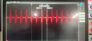

When I input a DC voltage with VIN of 6V and maximum 2A, VIN will generate intermittent oscillations (70Hz) causing the chip not to work properly, as shown in the red waveform below, I soldered a 4.7uF and 150uF capacitor on the input side and a 150uF capacitor on the output side at the moment. Is this problem caused by my capacitors being too small and how to fix it?

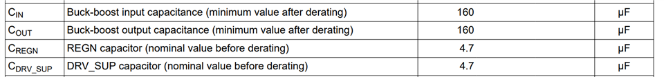

    The minimum input and output capacitance per datasheet is shown below:
    If you can read the I2C status and fault registers using your own MCU or the EV2400 software, we can confirm that the capacitance is the problem.

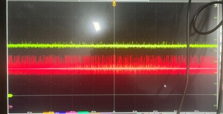

    2. My current output voltage still has a spurious waveform around 5V as shown below(red waveform). How can I reduce these fluctuations to get a more stable DC voltage output?

    Do the status and fault report any fault conditions?  If not, then you try disabling PFM mode.  PFM off results in the lowest output ripple.

    Some "faults" like IINDPM or VINDPM do not result in STAT blinking.  PFM is default on.  Does the ripple voltage reduce as the load increases?  At higher load, the charger exits PFM and enters PWM.

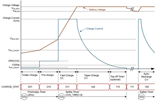

    In addition to that, I would like to ask if the chip decides the operating state based on the curve in the following figure when I set the voltage value corresponding to eload. For example when the CV load is set to 12V and the charging cutoff voltage is 16.9V the chip will be in Fast-charge phase?

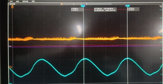

    I recently ran different tests by varying the input and output voltages and found that my voltage fluctuations appeared mainly when the chip was operating in boost mode using the eload test.
    When I set the input voltage to 10V and gradually increase the eload voltage from 5V to 16.9V, I found that the chip produces the fluctuations shown below (bule:VIN orange:VBAT) around 11.5V-16.8V, which roughly corresponds to the chip's Fast charge CC and taper charge CV phases, which I think may be the result of unstable eload voltage, as I read in other threads that connecting a supply voltage in parallel to the eload establishes normal operation of the chip.
    When I set VIN to 20V, the chip is able to work normally and stably with different eload voltages in buck mode (precharge, fast charge, taper charge ), I think this is due to the fact that the higher input voltage can clamp the eload voltage better.
    I think your issues are from the eLoad.  We use a source meter in parallel with a large capacitor to simulate a real battery.
