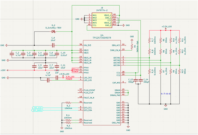

TPS25730: I'd like to get 20V and 1.5A out of a USB C power source, but I only get 5V
Part Number: TPS25730
I need 20V and max 1.5A out of a USB C source, but I get only 5V (with USB A to USB C cable) or something swinging between 3V and 5V (with an USB C to USB C cable)
I tried different sources but nothing worked out.
Thanks you for any help, I attach my KiCad desgin.
