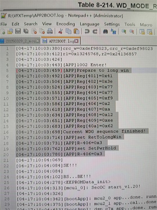

  • Q1.When received SW upgrade command,the system set WDG return to long window(WD_RETURN_LONGWIN=1),and set it to stay in long window(WD_PWRHOLD=1),but the watchdog just reboot immediately,how can let it stay in long window?
    When you set WD_RETURN_LONGWIN=1, the PMIC does not IMMEDIATELY return to the long window. It goes there after completion of the current watchdog sequence, after Window-2 ends. That means you must end the current sequence with  WD_FAIL_CNT < WD_FAIL_TH.
    Easiest way to do that is continue providing answers to finish the sequence and head to the long window.
    I recommend writing WD_PWRHOLD=1, once PMIC is in long window.

  • Hi expert,
    As the following log,I print all WDG register values,and wait the current sequence to finish,then set WD_RETURN_LONGWIN=1 successfully,but set WD_PWRHOLD=1  fail,the watchdog just warm reset immediately,why can't set WD_PWRHOLD bit?
    best regards
    wl.wang

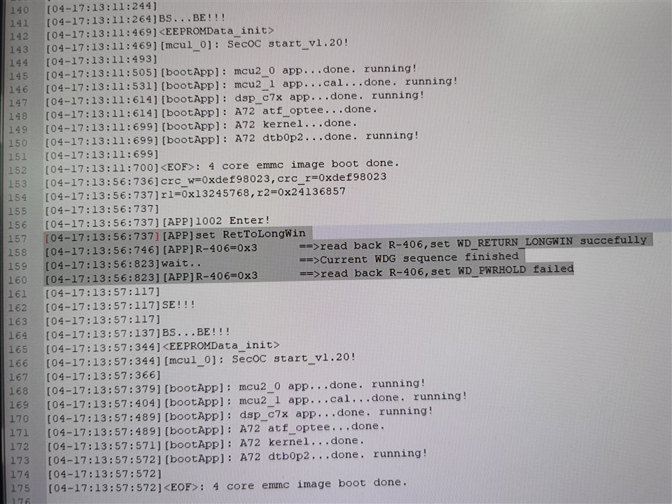

  • HI expert,
    Another case,I set WD_RETURN_LONGWIN=1 firstly,wait for current WDG sequence finished,then set WD_PWRHOLD=1 immediately,read back register 0x406,i found that WD_PWRHOLD be setted fail also,the device just do warm reset.

  • Another case,I set WD_RETURN_LONGWIN=1 firstly,wait for current WDG sequence finished,then set WD_PWRHOLD=1 immediately,read back register 0x406,i found that WD_PWRHOLD be setted fail also,the device just do warm reset.
    How are you confirming that the PMIC has returned to the long window before trying to set WD_PWRHOLD=1?
    Did you confirm that WD_FIRST_OK=0 after returning to long window?
    What line is the command to set WD_PWRHOLD?
  • Hi expert,
    At the moment of line 159,I set WD_PWRHOLD=1,and read back register 0x406 = 0x3 in line 160,it shows that WD_PWRHOLD=0 in BIT2
    Register 0x40a =0x62,it shows WD_FIRST_OK=1 in BIT5
    best regards
    wl.wang
  • On line 15, 0x40A = 0x62. This just means the FIRST sequence finished.
    After line 18, read register 0x40A. bit 5 WD_FIRST_OK=0 if the PMIC is back in the long window. Once you have confirmed the PMIC is back in the long window, THEN set the WD_PWRHOLD bit.

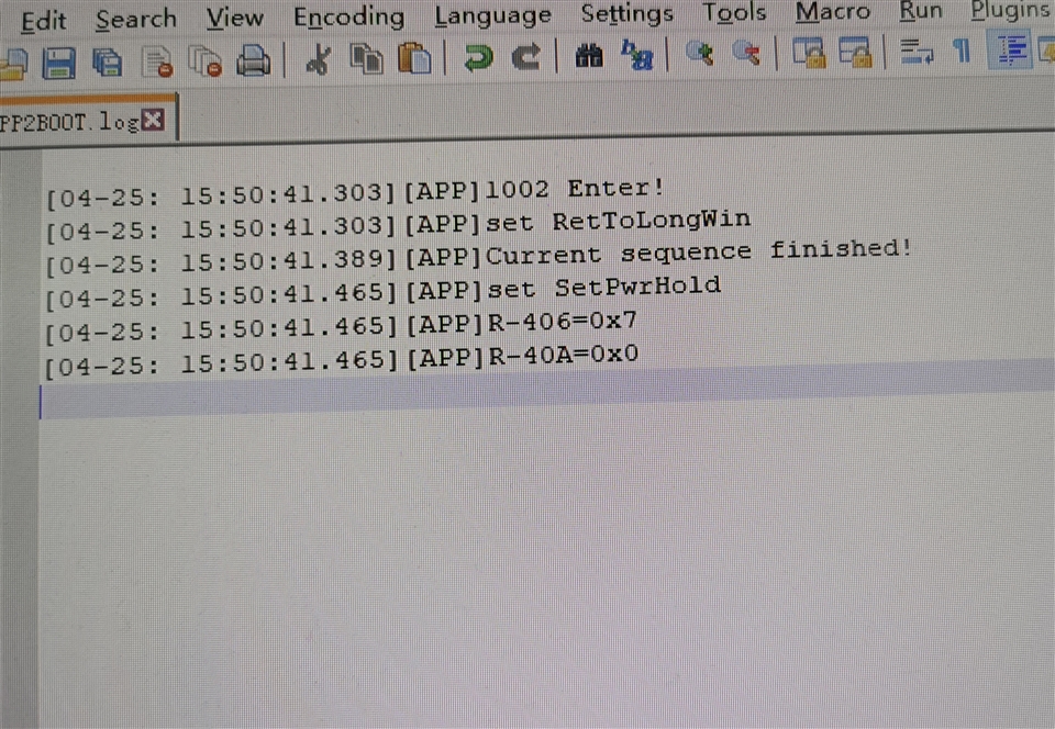

  • Hi expert,
    Now I can enter long window correctly.
    The reason why it didn't work before was that after entering the long window, the circuit would power down the system through the EN_SRV pin.
    best regards
