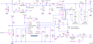

we have implemented a regulator with your component in SEPIC mode to produce an output of 110V, with a wide range input of 16.8V to 137.5 V.
The proto is working, but EMI disturbances are very high, due to LM51561H behavior and its circuitry. We need to lower at 15-20dB to comply to railways standards.

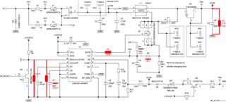

    We have also changed R5 to 4K7 and all the red components in the following schematic.
    With the modified circuit the we could only lower the EMI at 24V, but couldn't solve it up to 110V supply, which is our upper limit.

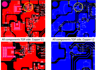

    The board has a double layer PCB. Please find the details below.

  • Hi Silvana,
    I have gone through your layout and found that you have a very large switch node area. Large switch node area is a major source of EMI because of discontinuous current.
    I would recommend to optimize this area and try to reduce the switching speed of the FET by adding a gate to source capacitor to it.

  • Thank you, Hassan, for your analysis.
    We were, in fact, very doubtful about the layout.
    1.Do you also suggest to increase the number of layer to add some GND planes inside?
    About the architecture, from first image of the schematic, you can see we have not included a proper common mode filter at input stage neither we have predisposed a RC filter connecting GND to EARTH (at the moment GND is floating).
    2. Do you recommend adding those filters?
  • Hi Silvana,
    Yes, I would suggest to use 4 layer PCB. With top land bottom layers for power routing. Try to place current going path top of the current return paths. In this way the power loop parasitic inductance will minimize because of magnetic field cancelation.
    Try to add ground planes around the power loop at top layer, it will also provide the magnetic field cancelation.
    Try to use third and forth layer for signal routing. With analog ground on third layer and signals at bottom layer.
    Yes, you have not use the decoupling caps at the input and output. Try to add multiple decoupling caps at input and output (100nF).
    Try to reduce the gate loop area because this can also be a source of EMI. Try to make a short connection to the gate. Going and return path for the gate signal should be place close to each other or overlap each other if you are using the two layers for gate signal.

    Connect the PGND with the AGND with one tie connection.
    Yes, if it is not battery driven device, then you can add a filter to connect GND to Earth. It will also provide a ESD protection to the device.
