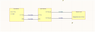

  • Hello Sepp,
    At the moment I don't have a schematic. It is more a "learning by doing" approach and I am still figuring out what is affecting what.
    I am using two eval boards which are connect by cables:
    https://www.ti.com/tool/TLV767EVM-014
    https://www.ti.com/tool/LM27762EVM?keyMatch=lm27762&tisearch=universal_search
    • The TLV767EVM outputs are connected to the LM27762EVM with 3.3 V.
    • The LM27762EVM is connected to a resistive load which simulates the adc.
    • Both boards have default configurations.
    I realize, that I did not mention this in my earlier post. Apologies for that.
    Here is a drawing of my setup:
    I assume, that in my case the distance from "input cap" to "device input pins" would be from TVL676EVM outputs to LM27762 inputs.
    Is that correct?
    Your question about the distance got me thinking. By reducing the cable length, the V_Peak_peak of the ripple will probably drop, because the cables length is proportional to inductance.
    I am unsure about the magnitude of the reduction though.
    And even with reduced distances, there will be a ripple on V_in, assuming a load of 1mA to 100 mA.
    Which leaves the following question:
    Does the remaining ripple has a significant influence, when using the LM27762 as a supply for the analog part of an ADC?
    Are my assumptions correct?
    Thank you for time,
    Regards and have a nice weekend :)
    Johannes
  • Hallo Johannes,
    Thanks a lot for the additional data.
    The noise/ringing on the device input which you can see on lower output currents is not coming from the device. It is a LC resonance ringing which is produced by a longer input cable and the input capacitor. This will be not the case on the real application normally. You can reduce this ringing with shorter cables and a 47uF Tantalum cap for more damping on the input of the device on the EVM. On higher output loads the device is continually switching without any pause so the resonance can not start.
    Please see also our app note of using additional filters on DC/DC converters: https://www.ti.com/lit/pdf/slvafe0?keyMatch=slvafe0&tisearch=universal_search
    Sepp
