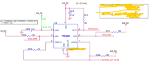

TPS3851: Can we use TPS3851G33 for VDD of 4.6V
Part Number: TPS3851
HI Team,
PLease see our scheme
OUr TPS3851 VDD is connected to 4.6V. So i am thinking about which voltage option part we need to select. IF we use TPS3851G50 then our VDD will be less than the VITN and REST# pin of TPS will get asserted always.
So can we use part TPS3851G33E for 4.6V VCC and watchdog function?
We want the TPS3851G33E to work as a Watchdog IC. VCC rail monitoring is not needed.  If we use TPS3851G33E the VITN will be 3.3V and VDD voltage will be 4.6V.  Will this make any issue to the watchdog functionality of the IC?
