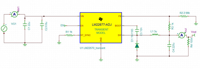

Hi
I was trying to simulate the LM22677 IC in TINA-TI , converting 14V input to 5V. I used the same values as given by the calculator but still couldn't get exact output so I changed the values by trial and error a bit and got 5V output but when I measured the current I observed the following
  • The input current spikes high 4-5A and then falls to zero
  • The output current fluctuates between 600u A
I tried using the same values from Web-Bench as well but it too gave like 7V output and 60uA current.
Why does this error happen? What can be done?

  • Hi Rahul,
    The RT resistor of 1k is too low for adjusting frequency, it will pull the RT pin low and enter synchronization mode. You can choose a value based on the RT vs freq. graph in fig. 12 of the datasheet.
    Also, please check the feedback resistor values again, I think the top and bottom have to be swapped for 5V output.

  • Thanks for the changes the resistors were placed opposite. But still the input current peaks 2A and then falls to 60u A and the output current still is 50u A what might be the problem?
    Regrads,
    Rahul Gandhi
  • Hi Rahul,
    The output current is set for 50 uA in your schematic because of the 100k resistor.
    Iout = Vout/Rout = 5/100k = 50 uA
    Input current will be high initially as the input and output capacitors are charged up then it will decrease to give only the output current.
    Niranjan
