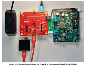

Hi, I am trying to demonstrate the following setup as shown in the image:
One TPS26750EVM with BQ25756EVM as a source to provide 24V 5A power. The power on the source comes from HV_SYS which is connected to a bench power supply.
One TPS26750EVM on the other side acts as a sink, sinking 24V 5A power. An EPR USB-C cable is used to connect them together.

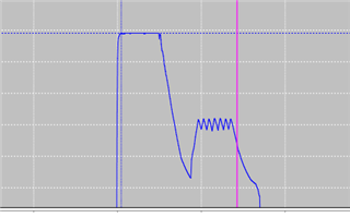

1) When HV_SYS = 5V, VBUS on source J4 and sink J4 were measured to be 3V. Doesn't look right to me.
2) When HV_SYS = 24V (or any voltage above 5V), the PP_EN and VBUS LEDs on the source flash at 1Hz rate, basically the VBUS output toggles between 0V and 5V every second. Seems like the system is constantly resetting.

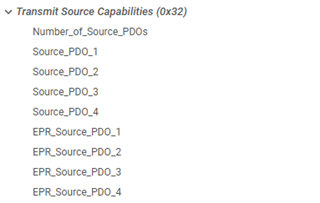

    While reviewing the jsons provided, I noticed that the maximum sourcing power is 240W, but only 5V/3A SPR PDO is set.
    According to the USB PD spec, when operating in EPR Mode, an EPR capable Source port should must offer 100W in fixed 20V.
    I suggest generating a new json file based on the default setting in Transmit Source Capabilities register in the GUI and testing with the same setup.

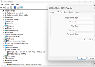

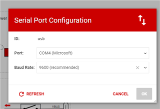

    One other issue I encountered today is not being able to flash the device.
    I believe the following images show that I have ensured the connection is working, but the app still says disconnected when trying to flash. Do you have any idea why it is? I have tried unplug/plug and connect/disconnect many times and tried both on web browser and native application. It was working properly last week though.
  • Hi Ming,
    Are you using the same PC that was used to flash the boards initially? Typically the EVM should show up as "TivaWare USB Serial Port" in Device Manager.
    Aya Khedr
  • Hi Aya,
    Yes, I am using the same PC. I found that rebooting the PC solved the issue. Please let me know when your have the setup validated on your bench.

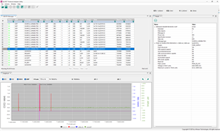

    I tried your jsons but my EVMs still exhibited the same behaviour. Please see attached files for PD log. The CCGX3 file can be opened inEZ-PD Protocol Analyzer Utility (EZ-PDTm Protocol Analyzer - Infineon Developer Center) to allow you to see the detailed decoded messages. You can the source capability didn't mention EPR PDOs. VBUS goes down as soon as the source SPR PDOs were broadcasted.
    A few things to note:
    1. I used a known-good Apple PD Wall adaptor (20V 3A) as a source, and using a TPS26750EVM with your sink json as the sink. The EVM works well sinking 20V. So, I think we can confirm the sink is working.
    2. How do I know if the BQ25756EVM is working properly? There is no indication on the board.
    pd log.zip

    I noticed that the Sink did not send any Request message to the Source in the PD logs. Also, the VBUS voltage does look abnormal.
    I suggest trying to test the Source PD+BQ board with a known sink device and see if it establishes a 5V contract. Ensure that there is I2C communication occurring between the PD and BQ. You can also measure the voltage on the VIN side of the BQ to ensure the expected output voltage is being provided.

    This is highlighted in section 2.3 in the EVM User's Guide
    Also, please refer to the following image to ensure proper jumper configuration on the BQ25756.
