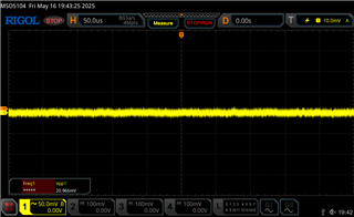

Hello.
I created a circuit based on LMR51430YDDCR to get 5V out of ~24V for a measurement application (requires low noise for opamp). Currently the load is only ~20mA. After activation, there will be a CAN transceiver drawing up to 70mA when sending.
Unfortunately I can observe almost 100mV ripple on the output in low load situations. It becomes better (but still too high) with more load. Therefore I appreciate any recommendation to lower the noise. Is there any general document from TI, that describes how to improve the circuit?
My circuit
L2 is Coilcraft SRP7050WA-330M

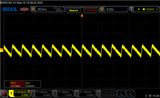

Measured output (yellow)
please ignore the peaks - there was an issue with my scope ref GND, which I noticed later.
Many thanks in advance for your help.

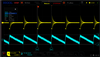

    Few questions:
    1. Where are you measuring output voltage?
    2. Are you using the EVM?
    Rahil
  • 1. I am measuring at TP3 - after the capacitor. If it helps, please find below the comparison between TP3 (blue) and the switching node (yellow)
    2. no, it is my own design

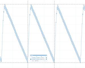

  • Hi Joshua,
    measuring with the tip GND didn't clear the issue - still 68mV:
    The C19 is a MLCC. I am not sure about ESR. The MPN is GRM32ER61C476KE15L

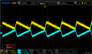

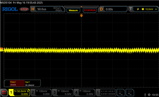

  • Sorry, it took a while until I had the new inductor and time to test. But today I can confirm, that this measure reduced the ripple significantly.
    Before:
    and after (with 3.3uH inductor):
    Thanks a lot for your support!
    Remark: On another board I exchanged the LMR51430 with a TPS563201 (unfortunately this device cannot reach the required input voltages) with the same (big) inductor and it was much less noise, and no superimposed frequency.
  • Hi Philip,
    You're welcome!
    Yeah that inductor may make sense with that device's internal compensation. However with the LMR51430 because of its internal compensation parameters and design, you are able to utilize a much smaller LC combination to provide a relatively clean, regulated output.
    Please let me know if you have any other questions.
