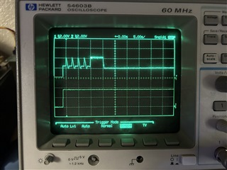

[1] For VCELL = 2.1 V, we see the following waveform at VPACK (channel 1) when a charger is inserted:
The behavior shown here is normal, and can be described as:
  1. 10% through 30% time division: the BQ25798 repeatedly disables and re-enables VPACK because the CHG FET is open at the beginning of the SUV delay, and the BQ25798 thinks charging has terminated. The BQ40Z50 keeps being reset before the SUV delay can complete.
  2. 30% time division: our system firmware intervenes and reduces the charging termination debounce time, so the BQ25798 can hold VPACK steady.
  3. 30% through 40% time division: the BQ40Z50 waits for the SUV delay to expire.
  4. 40% time division: the BQ40Z50 closes the CHG FET, and charging proceeds normally with VPACK = VCELL = 2.1 V. The cell simulator display confirms the cell is drawing the expected precharge current (500 mA in our application).
Originally, I feared that the gauge would shut down at 40% time division because VPACK is less than the charger present threshold, and VCELL is less than the shutdown voltage. To my relief, however, the gauge stays awake and the CHG FET can stay closed.
What is keeping the gauge awake in this case? Is there some other condition (charge current flowing?) during which the gauge will avoid shutting down? To be clear, what we're seeing here is desired behavior—I just want to make sure there are no other flash parameters we need to set to ensure this behavior can be consistent.

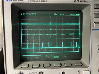

  • Hi Anthony—thank you for accommodating some delay on my side; I needed a little bit of time to set up this measurement again. Please find the results below:
    Channel 1 (top) is VPACK (2.1 V) = VCELL, while channel 2 (bottom) is the voltage measured at the TS1 pin. The amplitude of the pulse train is 600 mV—the measurement was taken at room temperature, so the NTC resistance would have been roughly 10k; the amplitude seems reasonable.
    It looks as though the period consistently alternates between 500 ms and 750 ms; it does not vary beyond this pattern. Please note that our design enables all four TSx pins in case this affects the sampling rate of the TS1 pin.
    The waveform suggests the internal pull-up resistor is briefly enabled at a predictable rate, so it does not seem as though the gauge is falling in and out of shutdown. This is corroborated by the fact that I2C communication is always reliable. In case I have misunderstood, please let me know.
    Furthermore, note that our design sets SUV_MODE = 1. If the gauge were entering and exiting shutdown, we would see the CHG FET open for 5 seconds each time. In this case, the CHG FET is always open; this is made apparent by the fact that the cell simulator (i.e. DC power supply) used in place of the cells consistently sinks the BQ25798 precharge current selected for our design (480 mA):
