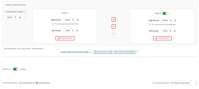

We will set shared power policy as two port 60Wmax total, one port 45Wmax and 15Wmin. Considering "45W charged capabile deviec such as laptop is connected to port B at first and portB starts to output 45W", after that, "another 45W charged capable one is connected to PortA", then PortB output 45W and PortA output limited 15W?
