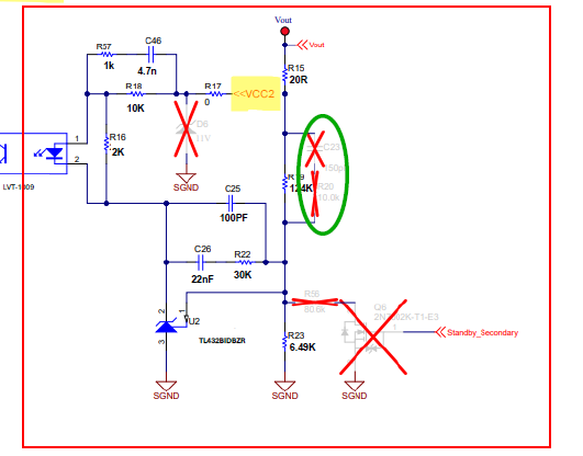

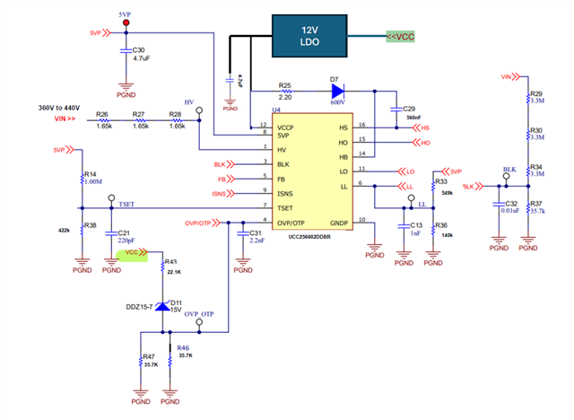

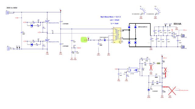

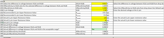

Dear TI Team,
We would like to seek your assistance with the following questions regarding the use of the UCC25660 for a customer design of a 400V to 50V Half LLC converter:
  1. Could you please provide the simulation model for the UCC256602?
  2. The calculation tool (UCC25660x_CALC_1.0.xlsx) does not include information on how to design the compensator. Could you assist us with this?
  3. Regarding the TEST option, could you explain how to interpret it and help us select suitable values?

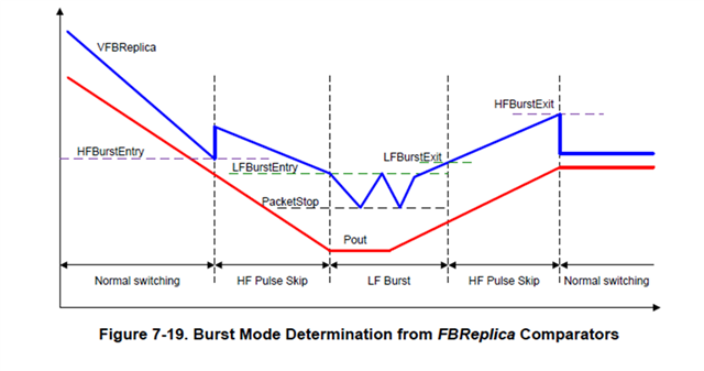

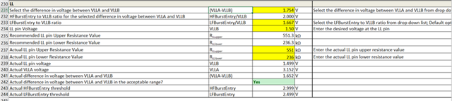

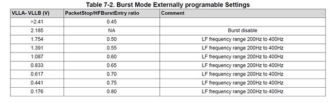

  4. Regarding burst mode, could you clarify the differences in operation when VLLA - VLLB(V) is 1.754 compared to when VLLA - VLLB(V) is 0.617?
 Thanks.
