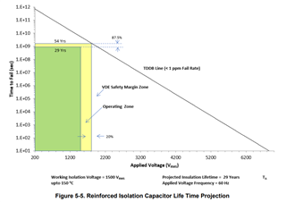

    2.) These isolated gate drivers are made to operate in high voltage/power systems where noise transients are expected. The insulation specifications in the product's datasheet (see snippet below) is a good reference to see what kind of conditions this driver is able to withstand.

    We already know that the datasheet defines the isolation specifications based on IEC standards, i.e. how much noise the IC can handle. What we want to know is whether the TI provides any information about long-term reliability (lifetime of the IC) in applications where commercial AC line-related noise is continuously applied to the high-side terminal.

    Is the TDDB curve sufficient enough to address your concerns?
    For more information, see https://www.ti.com/lit/ml/slyy191/slyy191.pdf
