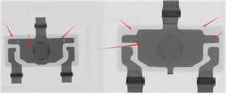

We found that the internal structure of this product is inconsistent, please help to confirm the reason

As shown on ti.com/quality-reliability-packaging-download/report?opn=TL431AIDBZR, this device is made at five different assembly sites, so it would be possible to get up to five different lead frames. (The assembly site is marked on the shipping label (22L, 23L).)
