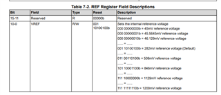

I’m already completed the 12 V buck-boost circuit, which is working, but I need a 5 V buck-boost.
How to change the circuit?

You can adjust output voltage by changing the Vref register. Recommend to evaluate loop stability again.
