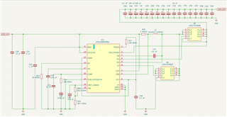

I have a boost regulator circuit designed by WEBENCH POWER DESIGNER for LM5123-Q1. It should boost from 6-8V on input to 12V on output. However in my case it seems like it is not switching at all. The output is similar to input with roughly 0.5V voltage drop (without load). By increasing load, the voltage drops more. The schematic is attached bellow. The C23 Soft-Start capacitor is replaced with 220nF capacitor.
What could cause or help to identify the issue?
