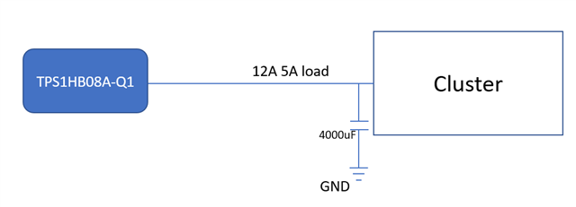

Hi Expert,
What is the maximum inrush current of the TPS1HB08-Q1?
Input Voltage 12V; TPS1HB08A-Q1, A version.
Xiaoxiang
Hi Expert,
Xiaoxiang
Update the load constant 5A.
Inrush current MAX 80A(forcase becasue the 4000uF)

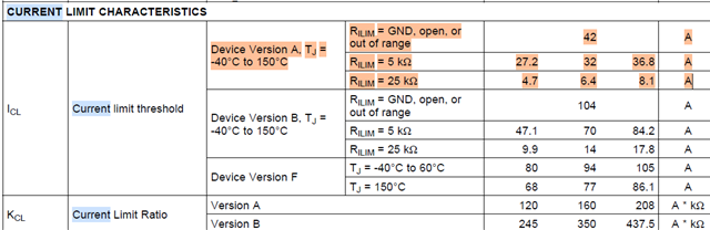

Hello Xiaoxiang,
This is dependent on the current limit set by the device. If ILIM is not externally configured the device relies on the internal current limit. I have attached a device comparison below.
Version F has the highest current range at 94A while version A can go up to 32A. When IOUT reaches the current limit threshold, ICL, the channel will switch off immediately. RILIM = GND is assumed to be a state where RILIM is shorted rather than intended state.
BR,
