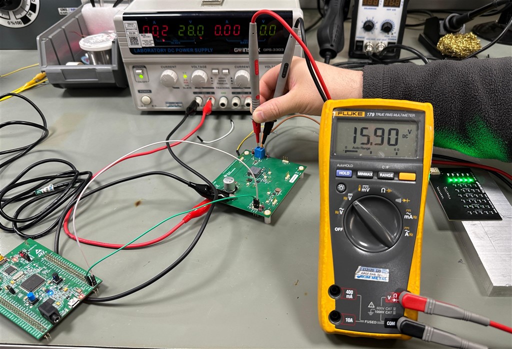

I did some test with tps922055evm and somethings confused my head. When supply voltage is 28V and no load condition, measurement of output voltage is about 26V. In load condition, my led forward voltage is 3.4V and 7 series. So ı measure output voltage and saw 23.8V in %100duty cycle. There is no problem so far. But when ı changed the load (3V x 5 led), Vout still 23.8V and my led blow. First question, why ı did measure 26V in first place? Second, Why didn't the output voltage change automatically when I changed the load?Because the datasheet says "VOUT is the sum of the voltage across LED load". Third question is how can ı be sure my led driver is working in cc mode?

    I have made some progress on evm board. That is why ı have new questions. Firstly, ı did not change any components of EVM board. When ı connected  3.4V and 7 series led series, the output voltage in%100 duty is correct. Changing of duty cycle is effecting Vout. After that, ı changed the load 3V x 5 led series and started from %0.1 duty. When duty comes %1, Vout is 15.6V and led current is typicall value, so ı can not increase duty anymore, because Vout increasing. I don't want to more voltage than 15.6V. I mean led brightness acting like pwm %100 in %1 duty.  It shows when change two different series led in same Duty, low one will blow. How can ı fix that problem?
    Note: I checked Dimming Mode Configuration, I used PWM Dimming mode.
    Example : Vin:28V Vf: 3V Series:5 Max output voltage:16V F:4khz
    D %0.01 =12.47V D %0.1=12.99V D %0.5=14.23V D %1 =15.6V

    Thanks for your feedback. I checked your question but maybe I am not fully understand what is the issue now. Actually, for LED, it's a normal characteristic that the LED voltage will increase with the current go through the LED. You can refer to the LED datasheet for it's IV curve to double confirm. I am not sure why the PWM dimming duty can't be increased from your side. Are you worried about that with the increase of the LED voltage, it might exceed 16V?
